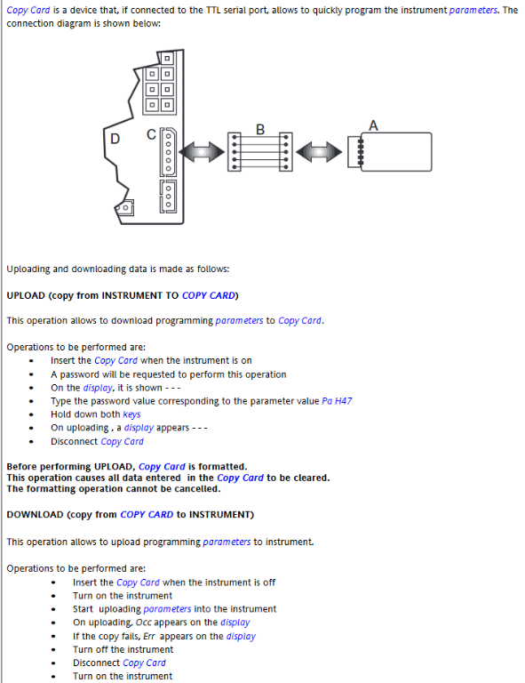

so with the copycard, you can transfert all the settings from one to an another Eliwell device BUT you need the password stored in H47 (Decimal Ad 2097)
easy with 210BDT it's "7" (read in doc)
but with 210B ? if the pss stored in H46 is " 47 " as you said earlier, try " 48 " for this specific copycard pss (logical if H46=47 so H47=48)

with the copy card you could transfer all parameters if you know the specific pss for copy card(H47 and not H46)
BUT you transfer on the new one (ech210bdt) the values from old one (ech210b) for parameters H26,H46,H47 and all visibility parameters

A password will be requested to perform this operation
On the display, it is shown - - -• Type the password value corresponding to the parameter value Pa H47 ,,,,neeting - - -• Il n'y a pas de possibilité d'entrer un mot de passe,,,,,
Rien! Il n'y a pas de possibilité d'entrer un mot de passe
Soit la carte copie est défectueuse, soit elle doit être formatée, mais comment ?
