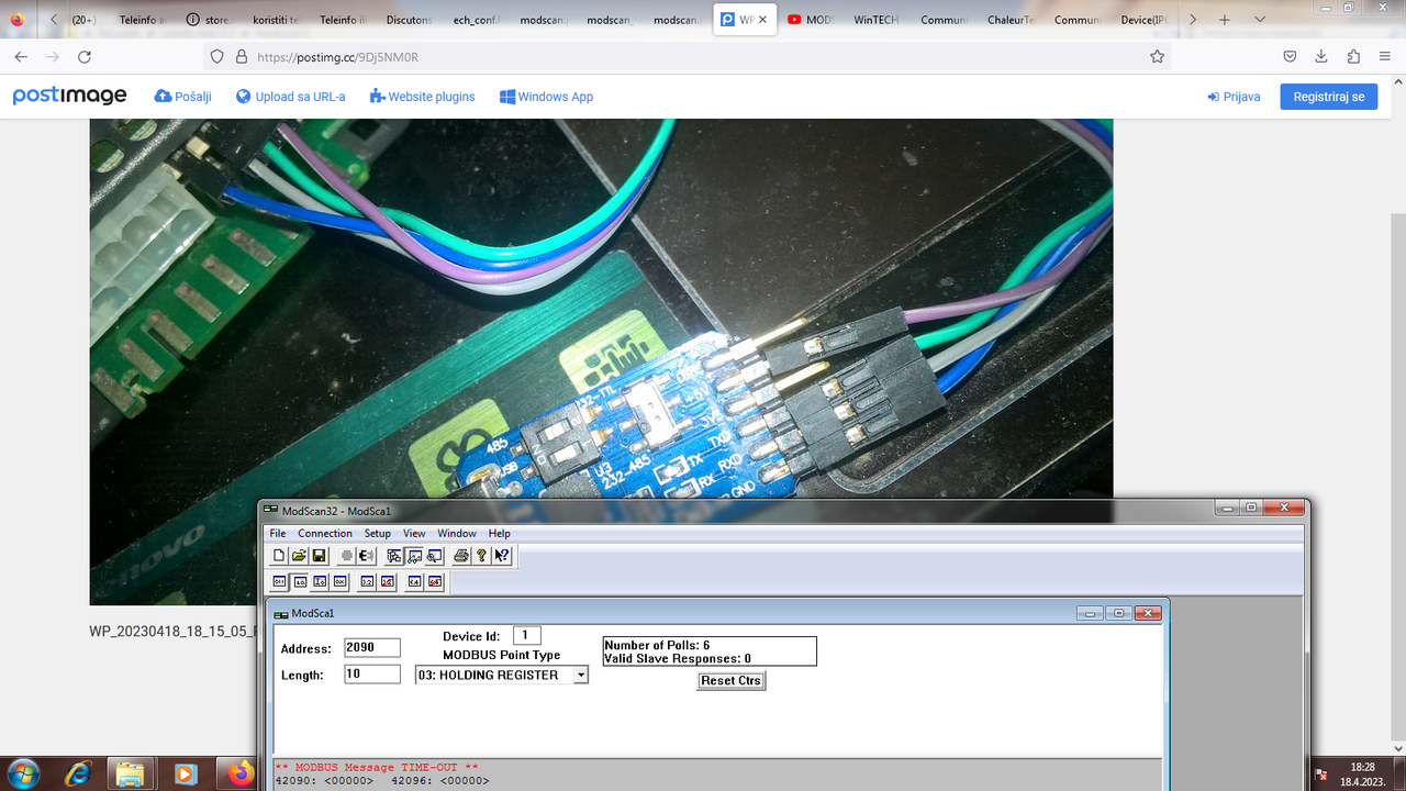

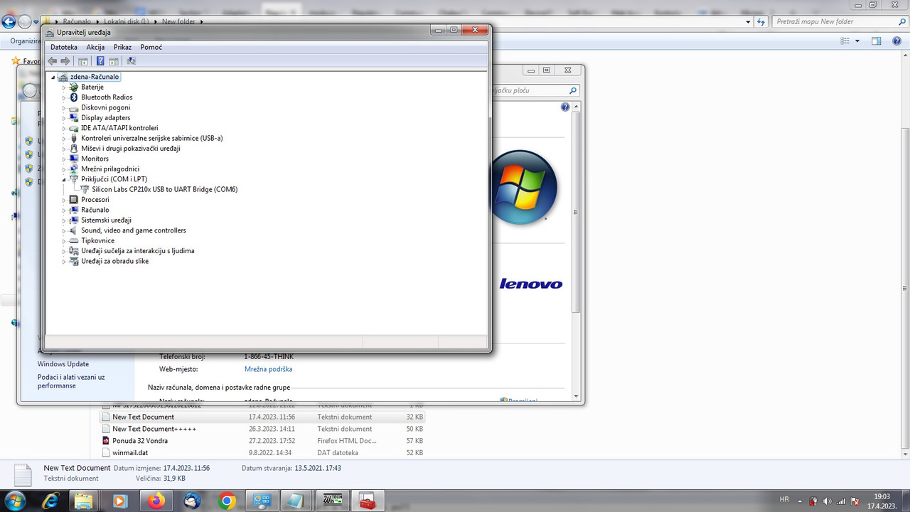

Hi
if all of those requirements are respected, it should communicate without time-out
or the usb-TTL converter is out of order ; in this case, you could test only the adapter with Hyperterminal ( or Putty or...) it's a loopback verification to test COM only on serial adapter (strap on pins Rx,Tx)
it's not necessary to have the ECH ON ; try to turn OFF (long press on down key)
if "time-out" still displayed, instead of polling multiple data, you could also read only one data
for example H26(0 or1) arround 2076 address or
around 2094 for H44 and H45 or
2096 for H46 (password you know now)
after this, if you can communicate with device, you will have to find the range for address for "visibility parameters" , to display or not the parameters on device display

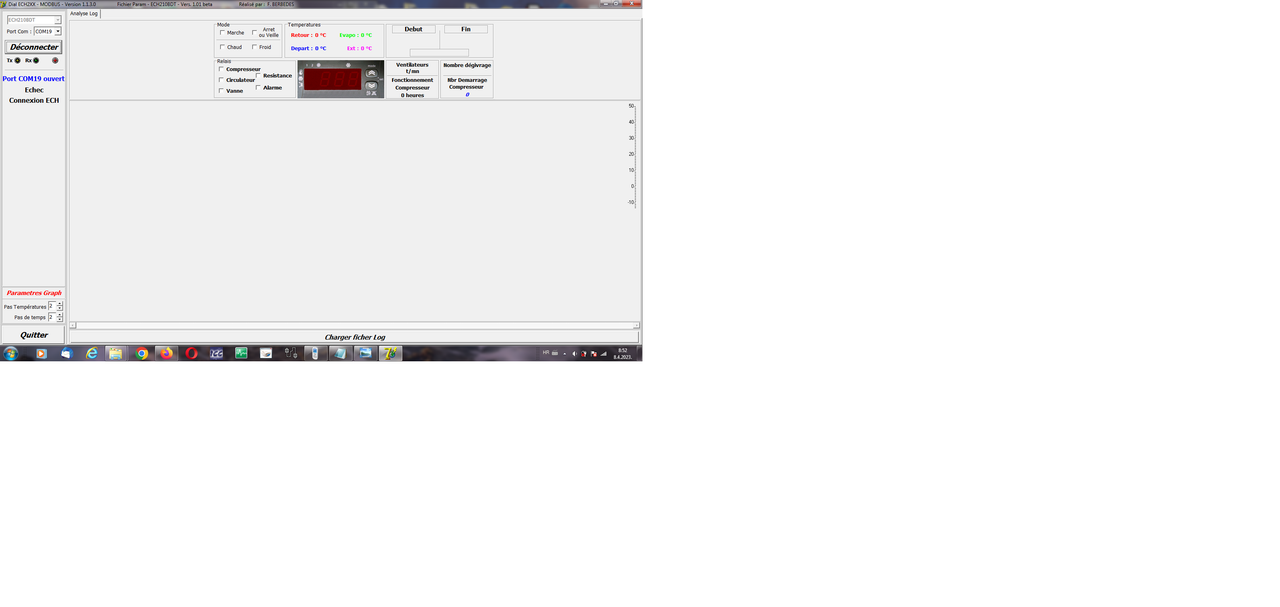

dfranc
- Messages : 28
- Enregistré le : sam. janv. 21, 2023 11:24 pm
Re: Régulateur ECH 210

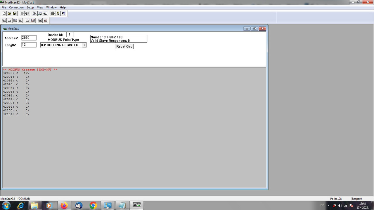

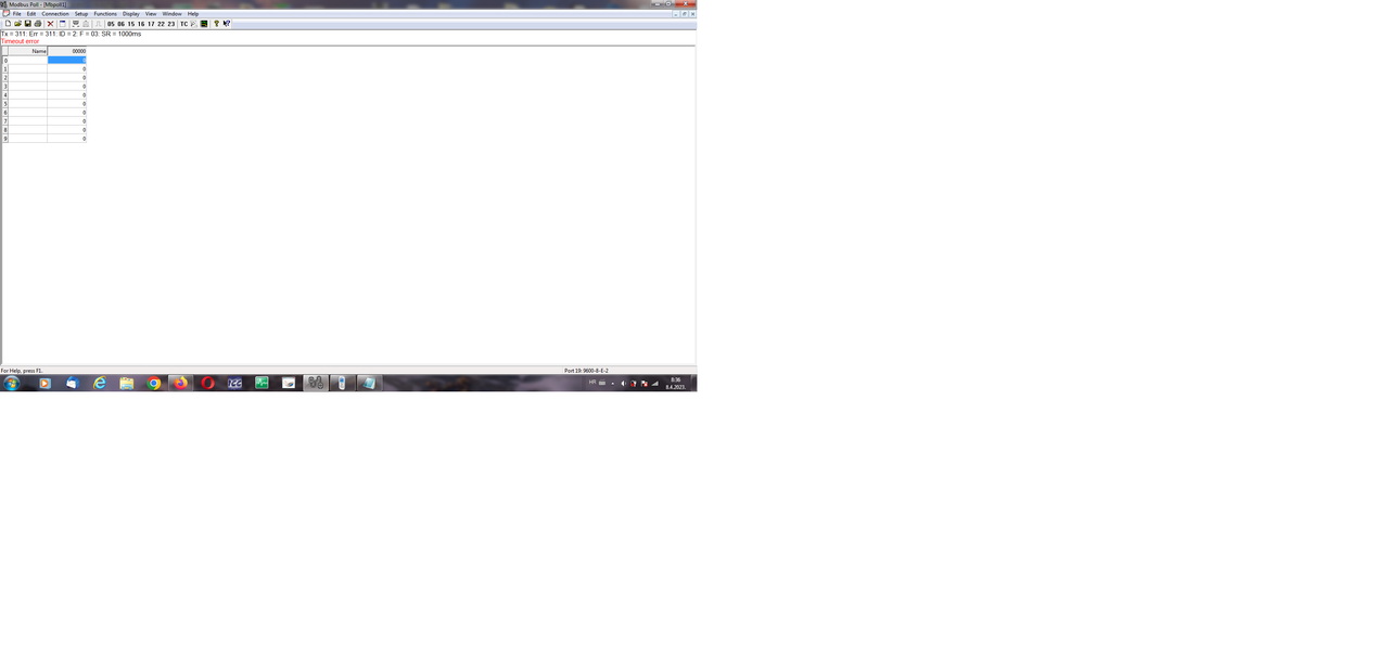

Bonjour, il semble que mon ModScan 32 ne fonctionne pas, où puis-je télécharger le bon ?
add photos online
Cela m'aiderait-il?
https://www.gastroparts.com/en/part-195909
add photos onlineCela m'aiderait-il?

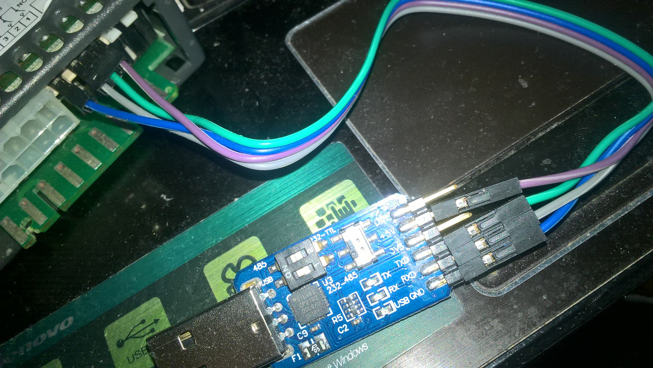

bubus
- Messages : 843
- Localisation : paca
dfranc a écrit : mar. avr. 18, 2023 4:12 pm Bonjour, il semble que mon ModScan 32 ne fonctionne pas, où puis-je télécharger le bon ?
could you send a picture of wiring between usb adapter and device ( to see if Rx and Tx are swapped as requested)bubus a écrit : lun. mars 13, 2023 11:59 am Hi

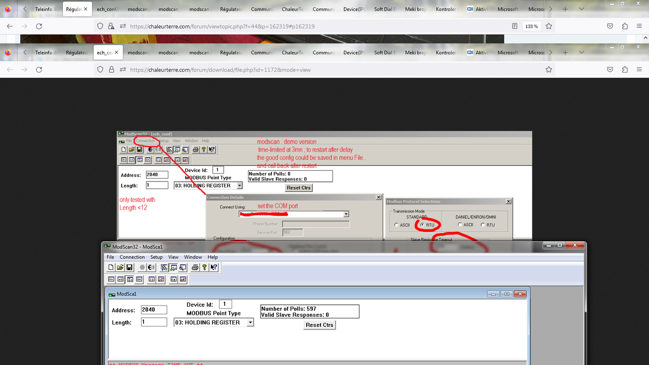

another Modbus Request Software : Modscan32 or 64
available here in demo mode (or with license):https://www.win-tech.com/
a quick demo :https://www.youtube.com/watch?v=STBX1Nc2I0s
nothing on your's picture to tell that modscan is out of order
